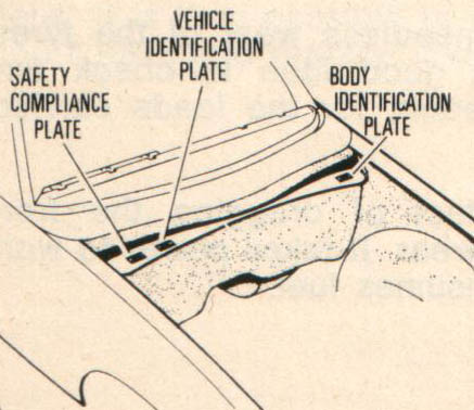

HQ Identification Plates Explained
The HQ plates are very similar to the other models, but we will breakdown the numbers to help identify a genuine HQ Sandman.
Only a small number of HQ Sandman's were built. Their production run was only 9 months through 1974, so any HQ van or ute dated outside of 1/74 to 9/74 can be discounted as a genuine Sandman.
HQ Plate Breakdown
Using an example VIN of 80170QH500025 we can breakdown the codes to something more useful.
80170 – 6cyl Belmont Panelvan
80270 – 8cyl Belmont Panelvan
80180 – 6cyl Belmont Ute
80280 – 8cyl Belmont Ute
80380 - 6cyl Kingswood Ute
80480 - 8cyl Kingswood ute
Q – Last letter of model
(HQ) H5 - Assembly Plant
H1-H4 – Brisbane
H5-H9 – Sydney
J1-J9 – Dandenong
L1-L5 – Adelaide
L6-L9 – Perth
Last numbers are the vehicle serial number.
ID Plate Location
id plates
